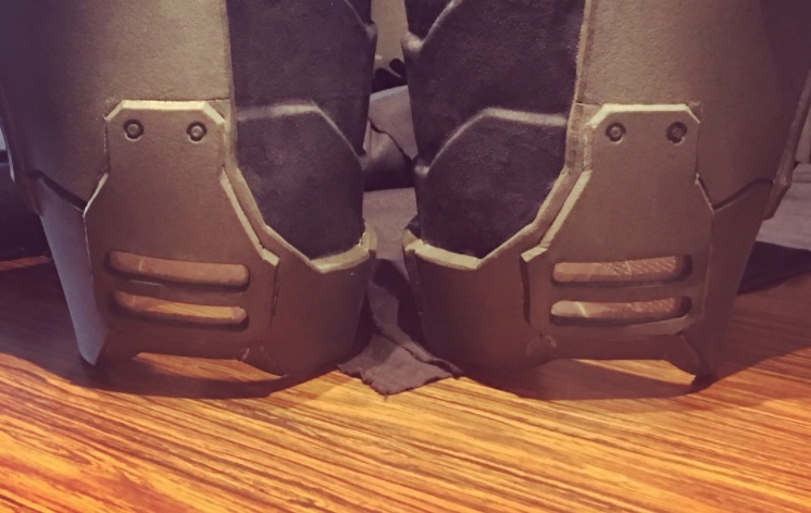

After the shoulders I tackled the thigh pieces, starting from the large, long detailed sections on The sides where the Magnum would mount in game.
I then worked my way around the front and back of the thigh towards the inner leg, making sure to mount the plastic for the light panels before sealing the piece together.
View attachment 295534View attachment 295536Many of the rectangular black buckles seen this suit were not a part of the pepfile and were templated by hand, all of the screw and rivet marks were achieved using various dremel bits.
For the inner thigh on this build I decided I wanted to try something different instead of painting the section that is a part of the inner leg but is technically a part of the undersuit. I built the piece out of 4mm TNT foam, and then using Super 77 spray adhesive, I skinned it with a black stretch faux suede. This route was taken to help that section of the armor blend better with the undersuit.

I am curious what you have in the shield emitters on the thighs. It looks like something clear, but I can't tell.

Its cut up old used chinese tupperwear lids

we have a few methods that we use, the easiest would have been difusing the plastic PRIOR to assembly, but soemtimes I burn my self out hand templating/ detailing and kick rocks down the road for a future me problem haha.Do you use something to diffuse the lights behind the take out container lid?
